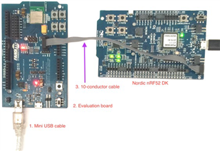

I am using NRF52832, twi_sensor_pca10040 example with SHT3X sensor.
I changed slave address to 0X44 and SCL, SDA pin to 27 and 26. TWI TX transfer work fine, in response I am geeting 6 byte of data from SHT3X sensor ( TWI slave address 0x44 ).
In twi_sensor_pca10040 example, from twi_handler() hadler, read_data() function is called. For received data manupulation, I changed code logic in read_data() function, called from twi_handler(). Every time read_data() function called I get HardFault_Handler fault  and board hang.
For testing, I commented read_data() function; then after TWI RX data buffer updates fine with every TWI TX request. I checked it by placeing read buffer in keil debug mode watch window.
Why function call from twi_handler() is giving me HardFault_Handler fault? I am not getting how to debug it?

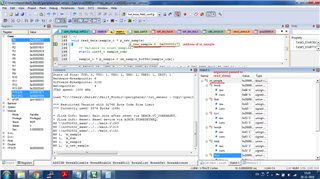

    void HardFault_Handler(void)
        uint32_t *sp = (uint32_t *) __get_MSP(); // Get stack pointer
        uint32_t ia = sp[12]; // Get instruction address from stack
        printf("Hard Fault at address: 0x%08x\r\n", (unsigned int)ia);
        while(1)
     * @brief Function for averaging samples from accelerometer.
    void read_data(sample_t * p_new_sample)
        /* Variable to count samples. */
        static uint8_t sample_idx;
        sample_t * p_sample = &m_sample_buffer[sample_idx];
    		m_sensor_val.temp = ( ( p_new_sample->tmsb.raw << 8 ) + ( p_new_sample->tlsb.raw <<0 ) );
    		m_sensor_val.humd = ( ( p_new_sample->tmsb.raw << 8 ) + ( p_new_sample->tlsb.raw <<0 ) );
    		m_sensor_val_f.temp = (m_sensor_val.temp * 0.00267033)- 45;

  • 1.If I write floating point multiplication code in read_data() funtion the I got hardfault on the first call to read_data(). If I comment floating point multiplication code, I am not getting any hardfault.
    2. Please find project file in attachment.
    3. Yes data is valid, you also can check the snapshot.
