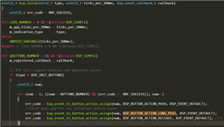

Hi
I was trying to do the page up and down key, I just built it successfully but it is no response.
Could anyone find out the reason for me.
I appreciate for your assistance.

    Moreover, there are several times when I press the button it will show "d" for the first time, especially when I press it after I have do other event with key board .
    //11/19 Wedy add for the combined key application
    		case BSP_EVENT_KEY_1:
    		    if (m_conn_handle != BLE_CONN_HANDLE_INVALID)
                    keys_send(8, p_key);
    								p_key = desk;
    								size=0;
    Do you have any explanation for this? Or I have miss any parts of setting?
    Besides, I also found the issue of below:
    //11/26 Wedy try for the combined key like presenet status (need to use with modifier(Window 0x08)) and add the sequence state
    static uint8_t WIN_HELP[8] = {0,0,0x3A,0,0,0,0,0};   //Win+F1
    I was trying to use the hotkey, but I just found that the combined key with Win + functional key (F1~F20) cannot use the same protocol like WIN+D.
    If I used the WIN_HEIP there is only F1 action is different from the WIN+F1.
    Do you have any ideal with this?
    Thanks for your patience.
    BR,
    Wedy
  • Hi Hakon,
    I just find out the way to release the Win like below change of setting:
    but there is still the problem with the "d" when the "Win+D" is pressed but seldom.
    Moreover, there is the issue when ever I press the  button from each to the other, it always show the past event for the first time. Do you know the reason?
    By the way, I also used the change to achieve the WIN_HELP.
    But according to some further application, I would like to know how to fit the following protocol for Window OS:
    i. “Win” + “F1” (raw data: 08 00 3A 00 00 00 00 00)
    ii. Release “F1” (raw data: 08 00 00 00 00 00 00 00)
    iii. Release “Win” (raw data: 00 00 00 00 00 00 00 00)
    because of my present solution is like:
    ii. Release “Win” + “F1” (raw data: 00 00 00 00 00 00 00 00)
  • Hi Wedy,
    I'd recommend using app_button instead of BSP. App_button is able to provide a interrupt on both rising and falling edge, ie: push and release of the button. BSP is not able to do this properly. This could be a source of the issue you're seeing, as it might not always release the key properly.
    If the modifier is 0x8, then it should be OK to send it in two request (push and release), like your last solution.
    Håkon
