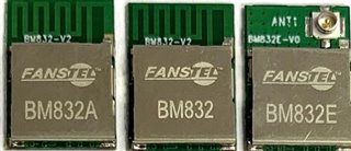

I am using Fanstel's BM832 bare chip which is based on nrf52832. The bluetooth isnt advertising. I'm using hid keyboard example & SDK 15.2.

It's not a bare chip. It's a module - that is, a bare chip mounted on a PCB, with some additional components, under a screening can, plus an antenna (or antenna connector):

Are you sure you're using a BM832 - not a BM832A ... ?
