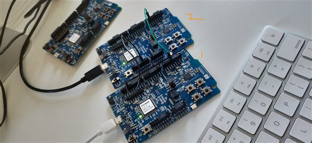

I am trying to establish UART communication between two nRF52 Dev boards. I flashed both of them with UART peripheral example from 15.2.0 SDK and connected TX,RX and GND pins.
Here, I encountered a weird issue where the two way communication(two terminals are recording the data when I enter data on any one terminal) is taking place with only one connection (TX from one board to RX on another / Connecting RX of both connectors) and nothing is being displayed on terminals when TX on both boards are connected. Can anyone explain this?
Thank you.
  • I'm afraid I haven't been able to reproduce this on my side.
    Maybe you could upload a picture of your setup with the nRF52-DK's?
    Also, you are using an unmodified version of the UART Hardware peripheral example?
    Located in <sdk_root>/examples/peripheral/uart
    Joakim.
  • Hi Joakim,
    Sorry for the delay. This is the setup with the nRF52 DK's.
    I connected the grounds on both boards(black wire). Also connected TX on board 1 (P0.06) to RX on board 2 (P0.08) using green wire.
    The code that I flashed on both boards is:

    After flashing, I opened putty emulator for UART ports on both boards. When I send characters from board 1; they are displayed on terminal for board 2.
    Next, when I send characters from board 2, they are being displayed on terminal for board 1 when I didn't connect board 2 TX to board1 RX.
    What might be the reason?
    Thank you.
  • Hi again.
    Thank you for the detailed description of your setup.
    We have been able to reproduce it using the same setup as you.
    However, I must admit that I don't know why that is working.
    I will do some digging and see if I can find an explanation to this.
    Best regards.
