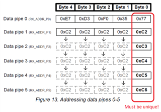

    The slave device in the above scenario will receive on pipe1 - 5, then send back on the unique pipe0.
    Are you ensuring that pipe0 is not equal to pipe1 in this scenario? The LSByte must be unique for all 6 pipes, per the datasheet chapter 7.6.
    Meaning that pipe0 LSByte cannot be equal to the LSByte on any of the other pipes.

  • Is exactly like you wrote. I am sure that we have unique address on each pipe all the time. When we change the address on pipe0, pipe on which we recived message get unique address.
  • It's not only the whole address, but the last byte must be unique, ie: pipe0 last address byte cannot be equal to pipe1 last address byte etc:
