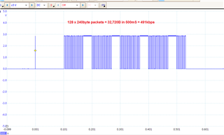

  • Update: Managed to get to 491Kbps which will be good enough for my application. Was able to update the min max connection times to 75 - 100, and the NRF_SDH_BLE_GAP_EVENT_LENGTH to 60. This seems to push a lot more packets through in each time slot.
    I think maybe with NRF_SDH_BLE_GAP_EVENT_LENGTH  = 6, the softdevice just did one packet per connection interval.
