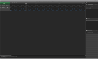

    I did some measurements by connecting a capacitor directly to one GPIO, then applying a 500 kHz pulse train.
    390 pF, standard drive (S0S1 in NRF_GPIO->PIN_CNF):
    390 pF, high drive (H0H1 in NRF_GPIO->PIN_CNF):
    1000 pF, standard drive (S0S1 in NRF_GPIO->PIN_CNF):
    1000 pF, high drive (H0H1 in NRF_GPIO->PIN_CNF):
    Based on the above observations, it should not be a problem for a single GPIO to drive a 262 pF load at 400 kHz. The GPIO struggles a bit when driving 1 nF at 500 kHz, with standard drive strength, but still should be able to open/close a FET with this gate capacitance.

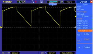

  • In our initial circuit we had 6 GPIO from the Nordic nRF52832 driving the gate of an NFET thru a 33.2 ohm resistor.  Here are the relevant parts of the schematic.  We connected P0.05 thru P0.10 together to drive the NFET.
    The intent was to drive all 6 pins from a single PWM channel so that all pins were in sync.
    • Frequency: 400khz (2.5us period)
    • Based on 16Mhz clock this meant we get 40 PWM counts.  This allows us from 62.5ns to 2.4375us pulse widths.
     In the initial programming of the PWM it seemed easiest to define all 4 channels to individual GPIOs and to try driving the gate with 4 GPIO.
    • We assigned P0.05 to P0.08 to the 4 individual channels
    • We defined P0.09 and P0.10 as unconnected inputs
    • We use a slight variant of the PWM library code nrf_drv_pwm.c (nrf_drv_pwm_init() and nrf_drv_pwm_simple_playback())
    • The variation is such that we can set the pin configuration to any strength we desire (S0S1, S0H1, H0S1, H0H1) in the PWM initialization.  The standard default in the Nordic library routine is S0S1.  Our tests were with H0H1
     The NFET we designed in was Vishay/Siliconix SQ2364EES.  This part was chosen because of its low RDSon
    • RDSon 240mOhm @2V
    • Drive Voltage (Max Rds ON, Min Rds ON): 1.5V 4.5V
    • Vgs(th) 1V @250uA
    This part has an input capacitance of 330pf @25V

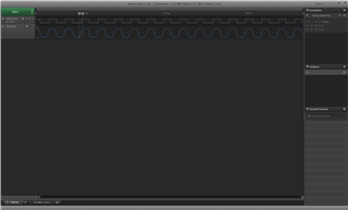

     The 4 GPIO do not seem able to drive this NFET, it could be because of the input capacitance or something else unique to this chip.  Here is an example of the drive at the gate.
    • We tried driving the chip both with and without a gate resistor (33.2 ohm)
    • We also removed the .5 ohm resistor in the source pin of the NFET circuit
     Here is a sample trace of the NFET gate (with no gate resistor or source resistor).  This is directly out of the 4 Nordic GPIO pins.  This signal is 50% duty cycle at 400khz.
    Note that the high level of the GPIO never goes above .7V, and when it tries to bring it to ground is very slowly ramps to ground
     Similarly, here is the same 50% signal, with 4 outputs set to H0S1
    It should be noted that NEITHER of these signals is actual turning on the NFET in a way that our circuit works.

    Here is a sample trace of the NFET gate (with 33.2 ohm gate resistor but no source resistor).  This is the actual gate signal.  This signal is 50% duty cycle at 400khz.
    Note that this signal goes all the way up to 3V, and though the edges are not sharp it does allow our circuit to work.

    The two devices you're testing with has the same pin out, according to their respective datasheets. However; It looks like there's something clamping your levels to ~0.7V in the first two scopes, which closely resembles a diode drop.
    What is the marking on your device? According to the datasheet (below "Product Summary"), it should be 9Jxxx on the SOT-23 package. Could you check that your part has this marking?
