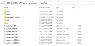

  • Hi.
    Can you use the files system_nrf51.c and system_nrf51.h found in \components\toolchain
    Download this zip file:embedded_studio.zip
    And place it like I have on my picture, in \components\toolchain
    Inside this file is a flash_placement.xml, ses_nrf51_startup.s and thumb_crt0.s which should work.
    Andreas
