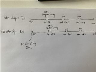

       Thanks a lot!Maybe my description is not clear to understand.I already use one nrf52 chip to transmit consecutive packets with 1us interframe spacing in 2Mbps mode,and the receiver can  receive the the first packet is delayed to 5us and the following packets with 1us interframe spacing.The diagram is as below:
    However,when I use four different tx chips with the interframe spacing (1us ~ 10us),the receiver can not succeed in receiving all the packets.So my main trouble is the difference between one chip and several chips when sending consecutive packets.Is the tx end the same tine with the receive end besides rx whole rx chain delay?
