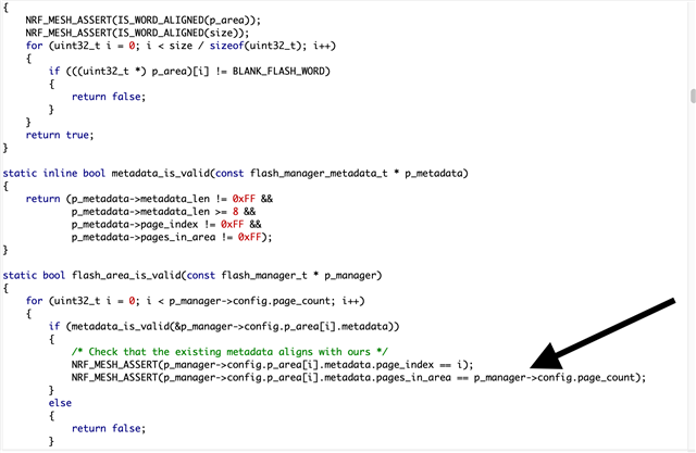

    Good news is that I traced out where the problem is occurring...
    It is happening in app_flash_init() function... and the exact location is shown in the figure below in the flash_manager.c file:
    The second nrf_mesh_assert() is causing the error when it is checking if the flash area is valid.
    We are storing some information in the flash like enocean data and few others. Is that causing this error?
     Well. If you try to modify an example to not store this information, and that works, then yes, that is probably causing the error. How (and if you know, where) are you storing the enocean data?
    And since you add this data somewhere, have you modified any defines in sdk_config.h or nrf_mesh_config_app.h to make sure that the rest of the application handles this data properly? (i.e. doesn't try to use that flash area for something else?)

  • How (and if you know, where) are you storing the enocean data?
    I am using the stock enocean example. I don't exactly know the location where the data is being stored. I am pretty sure that the enocean switch information isn't causing any problem as I added DFU functionality to the enocean example and pushed the dfu packet successfully.
    Regarding the other data that is being stored, we are storing them using random entry handles like 7EFF and 5EFF(which we assumed are the memory locations on flash).
     what do you mean by "entry handles"? Are you using FDS to store this data? Or perhaps fstorage?
  • what do you mean by "entry handles"
    It is the same way that you guys store the Enocean data in the enocean example. Create an entry handle and use app_flash_store, app_flash_data_store, app_flash_clear functions to write into and erase the flash.
