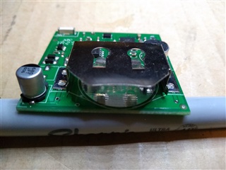

This project is a stripped down version of a product under development. It depends upon being able to change the contents of the advertising data whenever the board (a sensor) detects a new state. The code as shown generally works but eventually the device resets. This could happen after running for a few minutes or a few days or anywhere in between.

- Measure battery current while programming the device and discover programmer is sending current into the battery.
- Configure programmer to not send power to the device
- Retest 12 devices with fresh batteries.
At this point I am gaining confidence that the programmer was damaging the coin cells with the reverse current. I've appealed to Nordic to document this in the DK user guide and am converting this post to public in case they don't.
