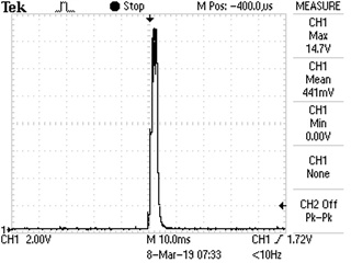

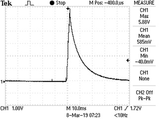

  • Here is th epeak current with the Sky chip active during Tx: ~6mA
  • For reference, here is what it looks like with the 680uF cap removed.  I had to use a smaller shunt resistor (0.333 ohm) to capture this so the peak current is 14./2000/0.333 = 22mA. The average is 662uA.
