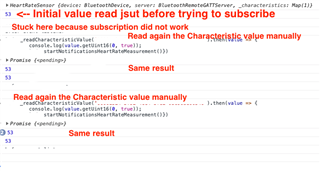

  • As an illustration, here is what my device looks like when it's working, I'm connected and I see value on my Characteristic :
    Exact same code, after few tries, here is what it look like. I'm connected but this time I see no value on my Characteristic :

    One new thing, to check if the issue is coming from the timer (maybe not started or whatever), I set a value to 0 after a new connection then in my timer condition, I increase this value and I send it in my Characteristic.
    Now I read this value before subscribing to the Notification then I subscribe to my Characteristic.
    When everything is working great the first time I read the value I get approximately 27 every time, so a little bit less than one second between the connection is made and just before the subscription. After the subscription I see the value increasing as the timer is fired and my subscription to the notification is successfully made.
    But when it's not working, the value is not 27 but usually 54 (so exactly the double). And the subscription to notification is not working.
    Now when it's not working, I read again the value, and this is the exact same value I get. This make me think that the timer is not fired anymore. Could this be because it's started twice at the same time or something like that and it crash ?
    Here is an illustration of when it's working and when it's not working on the console.
