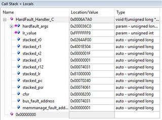

    So with RX_BUF_SIZE = 127 and the GSM whip sending 127 bytes data packet (so the configuration for which I have this issue), the code get stuck in an infinite loop in an hardfault_handler in the startup file arm_startup_nrf52.s :
    I'll try to obtain some more information as to the source that provokes this hardfault.
    UPDATE: I used a code given by ARM in order to get the registers that provoked this HardFault:

    Results:
    SCB -> CFSR = 0x00008200 ("cfsr")
    PC = 0x00070240 ("stacked_pc")
    SCB -> BFAR = 0x00074031 ("bus_fault_address")
    So apparently this Hard Fault is forced and actually comes from a Bus Fault, generated at the address BFAR and where at this point PC was 0x0007024.
    This is precisely the moment the code enters write() function from nrf_fstorage_nvmc.c file:
