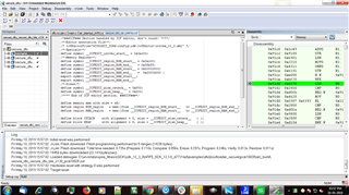

I am working on nRF51822 use IAR nRF5 SDK 12.3.0.
I am trying to debug the DFU in IAR. At that time i got an error show below
I use IAR version show below,
So pleas give me solution as sson as possible.

I also change of RAM address as you told but not run show like below,
The APP RAM base must be 0x200025e0. Can you try this and see if you get the same result?
Thanks for the input by following them my problem got resolved.
Thanks for the update. Note that the mdBT40 comes two memory variants so I think you may have the 16K RAM one since you had to change the linker settings to make it work.
I add initialization of DFU in my program and then upload program in device. Program runs successfully and starts advertising.
