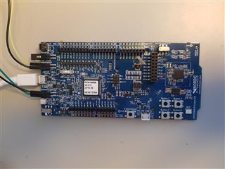

    Here's my DK setup:
    • Supply power to the P21 "external supply" header (3V).
    • Set SW10 (VEXT->nRF) to the ON position
    • Keep USB cable plugged in
    • Set SW6 to nRF ONLY
    • Set SW9 in VDD position
    • Measure current over P22
    Green wires are supplying the power and the yellow wire is measuring current

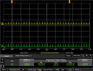

    And here's the current measurement running the ble_app_pwr_profiling hex. Green plot is current going into the green wire, and same with yellow.

    In your setup, you are using Green wire as 3V external supply, how are you measuring it on oscilloscope ?
    In the oscilloscope snapshot you posted, I see can see the marker 1 at 1,505uA and 2,487 uA , both the readings have a comma(,) in them, doesn't that correspond to 1.5 mA and 2.48 mA ? and same with maker 2 and average current.
    and we replicated your setup and this is the results we got
    our oscilloscope can't measure current directly, so we take the reading across a 10 ohms resistor, which in this case measures around 55 uA. Can you please take a look at this and tell me what's wrong?
