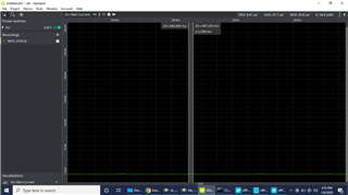

Hi all,
I wanted to see this below screen shot current number on nRF52840 DK
For that I changed peripheral/blinky example main() like this but I am seeing 14uA.

Can anyone please provide me the source code to achieve that 1.5uA number?

  • 1. No, I also see ~3µA using the PPK. This is likely due to leakage currents on the DK, and if you measure this as an external board, using the nRF Only setting and the debugger of another DK you should be able to see ~1.5µA. You can see how to do this in the PPK user guide.
