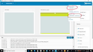

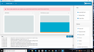

  • I TRIED TO FLASH THE SOFTDEVICE WITH "nRFgo Studio" AND ITS FLASHED SUCESSFULLY. THEN I TRIED TO FLASH THE BOOTLOADER WITH "nRFgo Studio" BUT ITS SHOWING SOME ERROR LOOK THE SCREEN SHORT.
NOTE:- when i flashed the BOOTLOADER  directly from the SEGGER IDE  its  flashing successfully  and its also advertising as "DfuTrag" and the OTA - firware update is taking place successfully too.

  • Hi Nandhu
    It should say when you hover over the file in the nRFConnect Programmer app for example. The settings, bootloader, and SoftDevice files should not overlap.

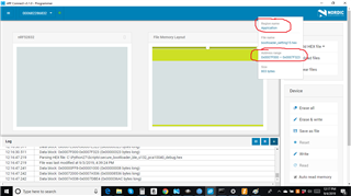

  • simon
    I ALREDY TOLD YOU THAT WHEN I TRIED TO FLASH THE BOOTLODER SETTING HEX OR COMBINED HEX FILE OF BOOTLOADER AND BOOTLOADER SETTING AS ERROR IS SHOWING ON nRF_Connect
    LOOK THE SCREEN SHORT BELOW
    • THEN WHO I FIND THE ADDRESS RANGE OF BOOTLOADER SETTING HEX
  • Hi Nandhu
    I just wanted you to hover over the bootloader/bootloader settings files with your mouse like I did. To see the address range of these files. Not flash it.

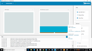

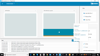

    Look the screen short below the bootloader is showing in softdevice region too and also the "Region name" is showing as application not as bootloader why? .
    BOOTLODER +BOOTLODER SETTINGS SCREEN SHOT ARE BELOW
    SOFTDEVICE SCREEN SHORT ARE BELOW
  • Hi Nandhu
    Sorry, seems I've misinformed you regarding the flash placement of the bootloader. The bootloader should be located at the "top" of the flash, meaning as high a number as possible (this is to make as much space for the SoftDevice as possible. Your bootloader is currently trying to be flashed at the top of a flash of 512kB. Which is why your QFAB with 256kB flash is not able to write it. So the start addresses have to be changed but to the top of a 256kB Flash instead.
    You can do this by going into the bootloader LD file and changing the FLASH (rx) : ORIGIN to 0x36000 (let the length stay the same). You'll also have to change mbr_params_page (r) : ORIGIN to 0x3E000 and bootloader_settings_page (r) : ORIGIN to 0x3F000. Lastly, you probably have to decrease the RAM (rwx) LENGTH as well.
