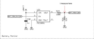

  • Hi, sorry for the late response.
    The pin where I connected the SAADC pin is not much accessible. I can connect the multimeter, but it will be hard to connect the oscilloscope and impossible to measure the current through it without desolder on the PCB. (I can't do this, I am not skilled enough)
    I have tried to disable most of the components, and as I said in my previous post only cut off the power of the LCD seems to allow a correct reading of the battery. I have tried reading the battery in timers and in normal loop operation, using blocking and non-blocking mode for SAADC, and all of them reported the same kind of problem.
    I had attached 3 images:
    1. It's an image of the MIC2091 layout which output is connected to resistor divider that is connected to the AIN0 pin of the nordic to measure the battery level. (I marked the point were I make my measurements.)
    2. It's an image of the battery charger layout which is connected to the battery and also to the MIC2091 input using the VBAT line.
    3. This is a partial image of the Nordic pins related to the battery monitor and charging.

    I just read your initial post again:
    During the initialization the reading is around 4.2 V for battery totally charged while later it drops to around 3.6 V.
     Is this when the battery is totally charged vs when it is almost depleted, or is it within a few seconds?
    And again, is it possible to shut everything else off? the LCD and everything potentially drawing a lot of current? Remember that the more current you draw, the more current will go through R24, and the voltage on your measuring point will be lower.
     This suggests that this is what is actually happening. The LCD draws more current, increasing the voltage drop over R24, decreasing the voltage on your measuring point.
    If you want a layout review, I recommend that you create a new ticket explaining that, and it will be assigned to one of our HW engineers.

  • Is this when the battery is totally charged vs when it is almost depleted, or is it within a few seconds?
    This drop happens within the first seconds, after the LCD is power up and configured, all readings from the SAADC drops but the readings on R26 and R24 with the multimeter stills the same.
    I have shut down everything, the only thing that seems affecting is the LCD. The LCD uses SPI communication, not sure if that is relevant.
    Well, I am not so sure about it, as I said above, the multimeter reads the same voltage drop on R26 and R24 during the boot, but the reading from the SAADC is for some reason different.
    Honestly, it's not that I want a layout review or similar, I attached the layout because you requested it. I just want to figure it out this issue which to me seems a software issue.
    Why do you think this might be a hardware issue?
    To me, the fact that the multimeter reads a voltage drop different than the SAADC reading mean that there is some kind of software issue.
