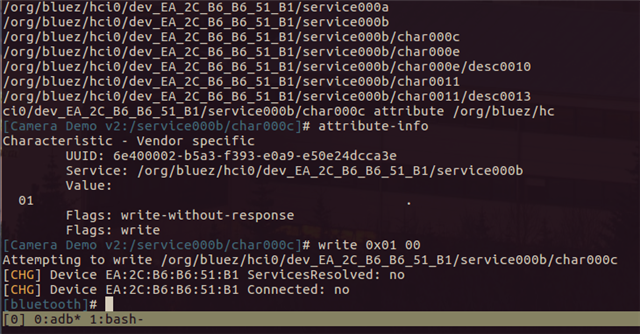

Above are the three UUID's that I have been writing to via the nrfConnect app. Using nRFConnect, I turned on notifications for UUID's 6e400003 and 6e400004. Then, according to the Android app, writing "0x01" to UUID 6e400002 should trigger a "StartSingleCapture". This is confirmed to work on the nRFConnect app, and I can see the picture data being transferred over.
However, when using the ubuntu tool Bluetoothctl, it seems like writing to the UUID 6e400002 does not trigger a notification on neither of the UUID's 6e400003 and 6e400004. According to a bluetooth sniffer, I am sending the data over, I'm just not getting a response from the Nordic board. Clearly this could be due to a variety of issues, but I wanted to reach out and ask if anyone on the Nordic team has had experience writing values to the nrf52DK using the bluetoothctl tool (version 5.50).

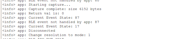

    I've traced the disconnection error to the ble_its_img_info_send() function. It returns a value of 8, which according to the documentation denotes an NRF_ERROR_INVALID_STATE error.
    As previously mentioned, this only happens when sending the bits with Bluetoothctl, not with the nrfConnect app. I will continue to look into what could be causing it to get to a bad state.

    However, I am still seeing a disconnection after that request. I added some prints to display the event id in ble_evt_handler(), and I will also post the data from my bluetooth sniffer, as well as the program that I'm using the interface with the Nordic Device.
    Here is a snip of the Segger logs, where the image is clearly taken, with a successful return value. The "Current Event State" of 17 is of interest here, as this is the value that the p_ble_evt->header.evt_id has before entering into the switch statement in the ble_evt_handler() function before a time out.
    Here is a snippet of me writing to UUID 6e400002. The value of the attribute is already {0x01}, but writing another {0x01 00} causes it to disconnect.

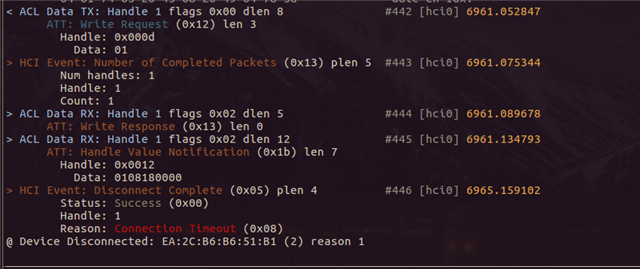

    And then here are the logs of my bluetooth sniffer, in which you can see that I receive a notification from what looks like UUID 6e400004, but nothing from the UUID 6e400003, before receiving a connection timeout.
    I can confirm that both UUID's (6e400003/4) had notifications enabled. Hope this helps.

    The data that I receive in the 3rd picture above from UUID 6e400004 of {0108180000} is the same data I get from that UUID when I successfully transfer data from the Nordic Device to the nRFConnect app. This is telling me that setting the notification for that UUID is working, and that it's specifically the reception of the data on UUID 6e400003 that is causing the issue.
