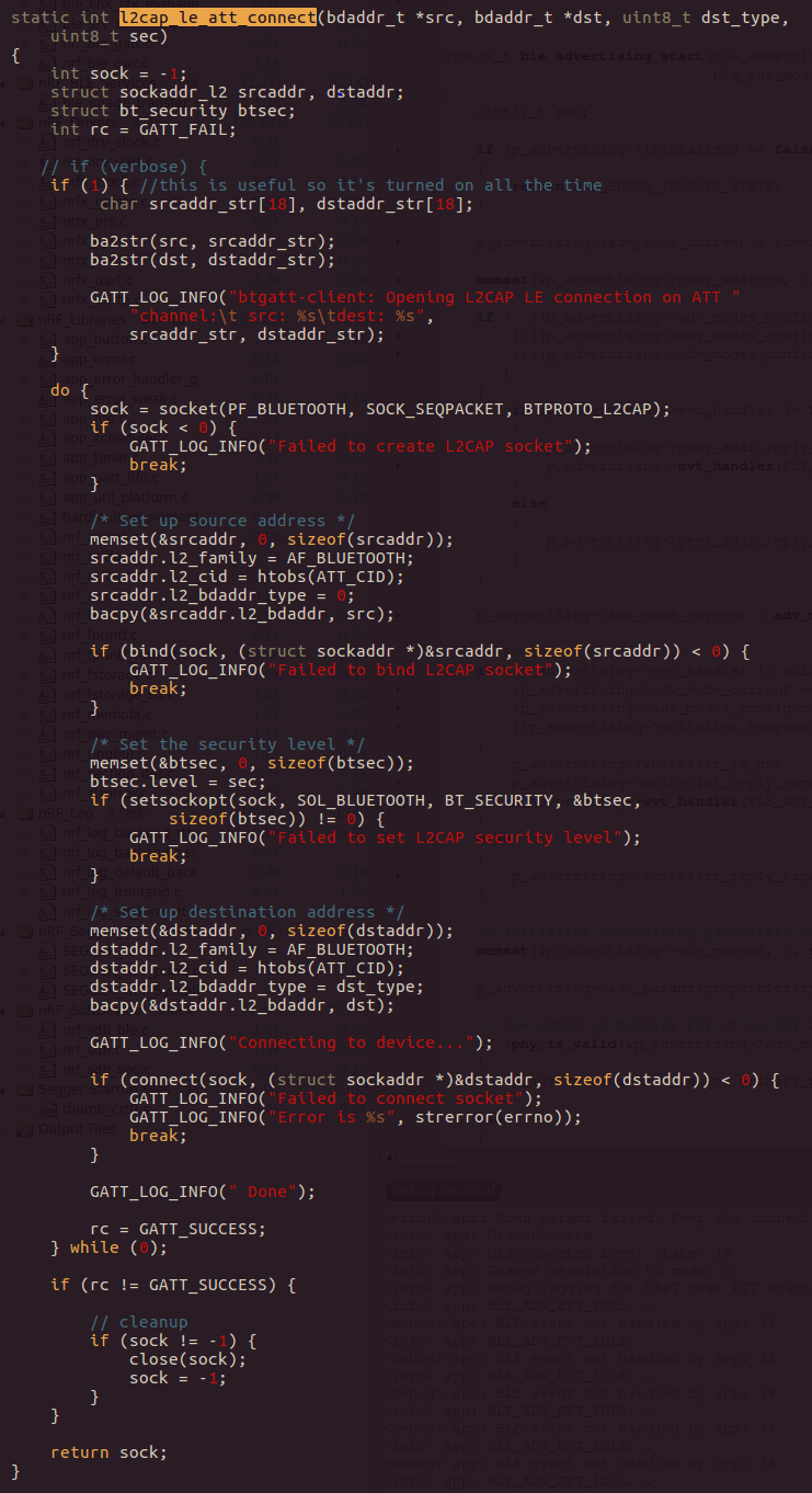

    The problem that I am now facing, is that I can't seem to connect to the board with code that I've written. Most notably, I'm not able to connect to a socket created to communicate with the board. I am receiving an "OPERATION NOW IN PROGRESS" error, which denotes that the I'm checking the return value for connect() before the board returns. My code works with all other bluetooth devices that I've paired it with, except for the Nordic. I've attached a picture of the function.
    I know that the original intention of this demo was the connect to Android, so I'm wondering if there are any special security levels or whitelisting that is required to connect to the board with a socket? As far as the board goes, I'm not even seeing an attempt at connection. I can confirm the socket code I'm using now work elsewhere, so I'm thinking that maybe it's returning faster than it can connect to the Nordic board.
    Any tips connecting to the Nordic board manually would be helpful.
