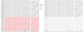

    On the last week I had took copies of debugging-ok and debugging-nok folders of my app. some notes of comparison by beyond compare.
    no difference in source code
    build_nrf9160dk_nrf9160ns/zephyr/zephyr.map files are exactly the same (but different dates, that's good to show that those had been re-compiled)
    build_nrf9160dk_nrf9160ns/mcuboot directory:
    .ninja_deps: file sizes very different, OK: 230k, NOK: 389k
    zephyr\edt.pickle: not exactly the same. I dont know meaning of that file but non-working one has one extra part starting on 0x000032E5 and beyond compare shows for its content to be partition related, even if just above is similar section (and that above section is also in the file in OK folder). Attached image shows it.
