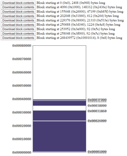

Buttonless DFU not flashing new firmware SDK 15.2.0
We are trying to get DFU to work on our custom board running nrf52832. It has previously worked on the devkit. Our board does not have a crystal so we are using NRF_CLOCK_LF_SRC_RC both in the bootloader and application. Our bootloader is based on the example secure_bootloader_ble_s132_pca10040, the only changes we made are led/button behavior, public key and enabled rtt logging for debugging.
We are testing the DFU functionality using nrf connect for android.
The bootloader receives the signed zip but does not flash it. Below are some errors from the log (Flash write/erase failed (0x3))

<debug> nrf_dfu_flash: Flash erase failed (0x3): addr=0x0007F000, len=0x1 bytes, pending 0
<debug> nrf_dfu_flash: nrf_fstorage_write(addr=0x0007F000, src=0x200074D0, len=440 bytes), queue usage: 1
<debug> nrf_dfu_flash: Flash write failed (0x3): addr=0x0007F000, len=0x1B8 bytes, pending 0

<debug> nrf_dfu_flash: Flash erase failed (0x3): addr=0x0007E000, len=0x1 bytes, pending 0
<debug> nrf_dfu_flash: nrf_fstorage_write(addr=0x0007E000, src=0x20007688, len=440 bytes), queue usage: 1
<debug> nrf_dfu_flash: Flash write failed (0x3): addr=0x0007E000, len=0x1B8 bytes, pending 0
<debug> nrf_dfu_req_handler: All flash operations have completed. DFU completed.
What could be causing those errors? I've also attached a more full log.

<debug> nrf_dfu_flash: nrf_fstorage_erase(addr=0x0x0007E000, len=1 pages), queue usage: 1

  • Hello, sorry for not pointing this out earlier but I just realized we use the QFAB version of nrf52832 with only 256kb flash. I was using an older version of nrfjprog and it would let me flash the full 512kb. After updating to latest command line tools it printed errors about data outside valid areas.
    I updated linker macros in segger to fit everything below 0x40000 address. Below is an image of everything bootloader, app and SD.
    Here's a list of things I've done, have I missed something?

    I generated settings with --family NRF52QFAB
    Unfortunately now the device is stuck in bootloader advertising as dfutarg.

  • Ok, and you're not able to perform a application DFU? Or did you want the device to boot to the application and not stay in the bootloader?
    Indeed, when I flash app+settings, sd and bootloader the app is supposed to load. I am also not able to perform a dfu through dfutarg.
    I have tried the debug bootloader(with logs) and normal bootloader and the behavior is different.
    Debug bootloader returns this:
    <warning> app: Aborting. Cannot fit new firmware on device
    <error> nrf_dfu_validation: Can't find room for update
    <debug> nrf_dfu_req_handler: Request handling complete. Result: 0x4
    <warning> nrf_dfu_ble: DFU request 4 failed with error: 0x4
    Non-debug bootloader accepts the zip (so it's not error 0x4 because the data is transfered), disconnects and then the board is not advertising anything
    I can even reproduce all this on the devkit, presumably something is wrong in my linker section placement macros.
