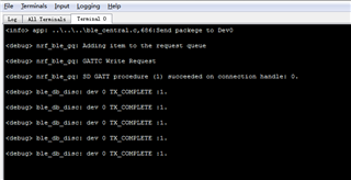

  • I had try as your suggestion,but i found when i send a packege to slave, there appear five time call back for "BLE_GATTC_EVT_WRITE_CMD_TX_COMPLETE".
    I don't think "Store initial queue element count in a variable" can work well.
    My chip is 52832,SDK 16.0.0
    I would suggest that you use either internal Softdevice queue (configurable ble_gattc_conn_cfg_t::write_cmd_tx_queue_size) or BLE Gatt Queue module for GATTC Writes. Actually, the Softdevice queue is a better option because you can track its size at the application level.
    You cannot assess BLE GATT Queue size the same way, because all Softdevice requests use exactly the same queue and the information about it is unavailable. So the algorithm for tracking the BLE GATT queue state cannot be used in this case: "Store initial queue element count in a variable" can work well....".
    You are probably using both queues in your solution (judging from your screenshot). In that case, the SD queue will fill up first and the BLE GATT Queue will be used. That's why you see the disparity between the number of times when the item was added to the BLE GATT queue (only 1 time in your screenshot) and the number of BLE_GATTC_EVT_WRITE_CMD_TX_COMPLETE events (5).
