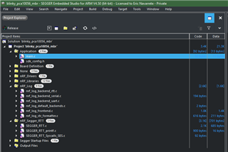

Hi all, I apologise for this very basic question, but I don't understand how to add/enable RTT debugging to my code. I want to practice writing basic code for the NRF5 SDK, and I think adding debugging to the blinky example is a good step.
What I have done is:
-Copy the "blinky" folder from ...nRF5_SDK\examples\peripheral\blinky  to a new folder   ...nRF5_SDK\my_code\peripheral\blinky
(Did this to keep my test code separate from the examples)
-Replace the config file ...\nRF5_SDK\my_code\peripheral\blinky\pca10056\mbr\config with the config file from ...\nRF5_SDK\examples\ble_peripheral\ble_app_blinky\pca10056\s140\config
(Did this becuase ble_app_blinky example uses RTT debugging, and I know it works)
-Add nrf_log_backend_rtt.c and nrf_log_default_backends.c to the nRF_Log folder in Embedded studio from ...nRF5_SDK\components\libraries\log\src
(Did this to match the ble_app_blinky example)
-Create folder nRF_Segger_RTT in Embedded studio, and added SEGGER_RTT.c , SEGGER_RTT_printf.c , SEGGER_RTT_Syscalls_SES.c   from ...\nRF5_SDK\external\segger_rtt folder
-Use CMSIS configurator to make sure NRF_LOG_BACKEND_RTT and NRF_LOG_ENABLED are enabled in sdk_config.h
(Need to be enabled to work)
-Modify main.c to use logging.
When I do those steps, the code builds, but when debugging, nothing shows on the debug terminal
Here is the main code:

Project items in SES:

  • Thank you for your response, I have seen that tutorial, however I am using Segger embedded studio. The tutorial only mentions Keil, also the RTT files it says to download don't include syscalls for Segger embedded studio, so I thought it wouldn't work. As for what I have done myself, I have tried using the SES built in debug window, Segger RTT viewer, and a Serial monitor, but nothing shows. The code builds fine in SES. Thanks

  • Hi Eric,
    I took your code, reverted to the original blinky sdk_config.h(so you could see exactly what needs to be added), and added the following:
    #ifndef NRF_LOG_ENABLED
    #define NRF_LOG_ENABLED 1
    #ifndef NRF_LOG_DEFERRED
    #define NRF_LOG_DEFERRED 0
    #ifndef NRF_LOG_BACKEND_RTT_ENABLED
    #define NRF_LOG_BACKEND_RTT_ENABLED 1
    #ifndef NRF_LOG_BACKEND_RTT_TEMP_BUFFER_SIZE
    #define NRF_LOG_BACKEND_RTT_TEMP_BUFFER_SIZE 64
    #ifndef NRF_LOG_BACKEND_RTT_TX_RETRY_DELAY_MS
    #define NRF_LOG_BACKEND_RTT_TX_RETRY_DELAY_MS 1
    #ifndef NRF_LOG_BACKEND_RTT_TX_RETRY_CNT
    #define NRF_LOG_BACKEND_RTT_TX_RETRY_CNT 3
    #ifndef SEGGER_RTT_CONFIG_BUFFER_SIZE_UP
    #define SEGGER_RTT_CONFIG_BUFFER_SIZE_UP 512
    #ifndef SEGGER_RTT_CONFIG_MAX_NUM_UP_BUFFERS
    #define SEGGER_RTT_CONFIG_MAX_NUM_UP_BUFFERS 2
    #ifndef SEGGER_RTT_CONFIG_BUFFER_SIZE_DOWN
    #define SEGGER_RTT_CONFIG_BUFFER_SIZE_DOWN 16
    #ifndef SEGGER_RTT_CONFIG_MAX_NUM_DOWN_BUFFERS
    #define SEGGER_RTT_CONFIG_MAX_NUM_DOWN_BUFFERS 2
    #ifndef SEGGER_RTT_CONFIG_DEFAULT_MODE
    #define SEGGER_RTT_CONFIG_DEFAULT_MODE 0
    I also included the source files nrf_log_backend_rtt, nrf_log_default_backend and nrf_log_backend_serial from components/libraries/log/src, as well as the segger_rtt files from external/segger_rtt(along with adding its include path ../../../../../../external/segger_rtt to the end of the project included directories - options->preprocessor->User Included Directories). You can find this setting by right clicking on the project name, at the top of your project directory and selecting options.
    These files seem to be included in your project in your screenshots, but not when I opened the project files you sent earlier.
    The result from this is "Invert!" being printed in the RTT terminal along with the leds toggling like in the blinky example, the RTT output is seen in the included image.
    I recommend that you use the program "J-link RTT Viewer" for viewing RTT messages, instead of the built in SES debug window. I find the debug window often behaves unexpectedly. Mind you that you may not have J-link RTT Viewer open at the same time as the debug terminal in SES, that will not work.
