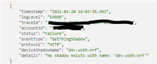

    On port 8333, MQTTEVT reports -128 i.e "Socket is not connected".
    I tried a different port (443), it doesn't return an error, but the connection isn't stable yet.
    In AWS cloudwatch logs I can see this:

    Also your error shows an error to do with the shadow name. AWS recently added the notion of "unnamed" and "named" shadows and they have different Topics so you may want to read abou that. I also found aws_iot.c of NCS includes a full "Client ID" whereas AWS only asks for a shadow with "thing name", the format of the topic is as follows:
    $aws/things/thingName/shadow
    So i ended up changing the sprintf() where cliend_id_buf is populated so it can build the topic strings, so that it doens't use CONFIG_AWS_IOT_CLIENT_ID_STATIC but uses a new config I added
    CONFIG_AWS_IOT_THING_NAME that reflects only the ThingName not the full client_ID or what AWS calls Amazon Resource Name
    do you have any comments on this discrepancy between Device  shadow MQTT topic format that AWS requires and what is specified in aws_iot.c of NCS?
