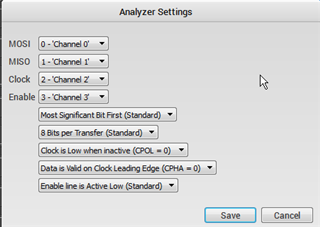

    I may have my i/o lines swapped but this is my analyzer set up. If this is not right what should it be?
    EDIT: oh I see its clocking on the rising, should be falling.
  • Ok I believe that is now corrected but no change in my issue.
  • Can you show write and then readback? E.g. of CONFIG register (0x00).
    write: 0x20 0x0A
    read: 0x00 0x00

  • UPDATE: so after changing the clocking edge I apparently bumped out the MOSI wire and that cause the condition above. After plugging it back in I see my register data.
    Still nothing on the receiving end but now I have a path to fallow down.  That arduino library is really hard to use but I like the GUI debug.
