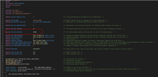

I am not able to find APP_ADV_DURATION and there are lot of ble_evt_handler. Where exactly?. I am using SDK 13 by the way.
It should be defined at the top of the file. I'm using SDK 16.0 and it looks like this:
