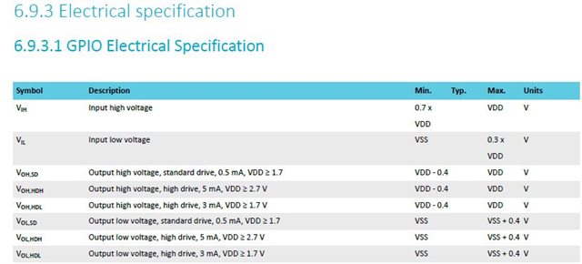

  • Thank you very much for your patient explanation, I understand what you want to express, I would like to ask, my NRF52840 power supply 1.8V, when the output logic is "1", what is the level range?  Looking forward to your reply, thank you
  • The nRF52840 port pin input/output specification is very similar to the RS485 chip you are using when nRF52840 VCC and RS485 VL are both 1.8 volts. Output low 0.4 volts, output high 1.4 volts worst case. VSS is of course GND, VDD is VCC ie 1.8 volts, just different naming convention.
