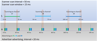

    Just want to add to the conversation that the reason Mesh nodes typically draws more power is because they have the radio on at all times in order to scan for incoming packets. The reason this draws more power than a normal BLE connection is that BLE connections only use the radio in short bursts.
    If you use the remote devices as scanners, it will draw more current than an advertisement. Actually, the radio consumes a very similar amount of current in RX and TX mode. Scanning is therefore a more current hungry procedure, because you typically have a scan window which is a lot longer than the TX window used for an advertisement.
    It works like in this figure:
    (Source: https://devzone.nordicsemi.com/nordic/short-range-guides/b/bluetooth-low-energy/posts/bluetooth-smart-and-the-nordics-softdevices-part-1 )
    In a mesh the scan window will be close to 100% of the scan window, so if you have the remote devices scanning with 50% of the scan interval, then it will consume ~50% of the mesh current consumption.
    This is also the reason why a phone usually does the scanning, because they typically has the bigger battery.
