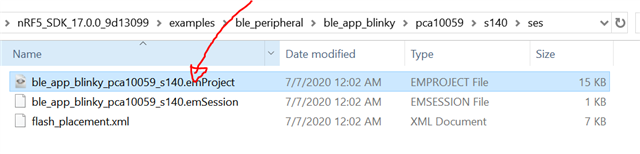

I'm new with Nordic products, I bougth one nRF52840 and I tried to install Segger, to start programming.
I had a problem when I tried to open a SDK on Segger. When I try, show to me a warning message and after a erro (Images bellow).

    • If you're using the nRF5 SDK (e.g. nRF5 SDK 16.0.0 or  nRF5 SDK 17.0.0) you should use the original version of SES. The one that can be downloaded from here and the one used in this video series
      • It may work to use the Nordic Edition anyway, but I don't think it is the intention
    • If you're using the nRF Connect SDK, you should use SES Nordic Edition. Which is the one that is included with the Toolchain Manager

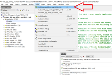

    • Build your project:

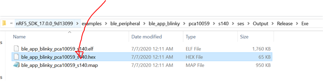

    The hex file is now located here:

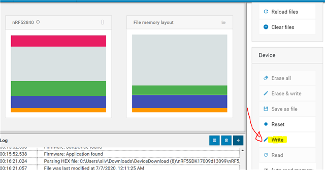

    • Connect the nRF5840 Dongle and Press the reset button to put the Dongle in DFU mode.
    • Open the programmer app select the device and drag the file ble_app_blinky_pca10059_s140.hex into the app
    • If not already present on the dongle, add the SoftDevice as well, it is located in nRF5_SDK_17.0.0_9d13099\components\softdevice\s140\hex\s140_nrf52_7.0.1_softdevice.hex
    • Eventually click "Write":
    • After you've downloaded it a message "Nordic DFU Trigger Interface was not found.." might show up. But don't worry about it
    • You can now see the device advertising as "Nordic_Blinky" e.g. by using the nRF Connect app on the phone
