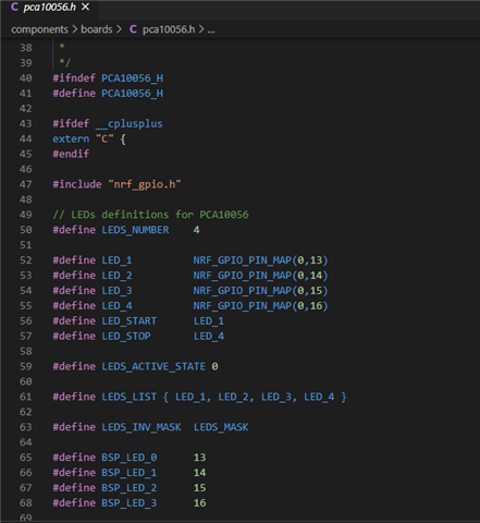

  • Ok so to summarize if I use the nrf52840 chip but not the development kit, I need to make a custom board matching my pin assignment. This means, I can't use any of the SDK default examples? What do I do about a soft device since I am intending to use Bluetooth?
    Also, where can I find these files that have the low-level sections? I cannot find a .h file for any of the boards on which I can write a custom_board.h file
     Well, yes, you would have to make a custom board file for your custom board. You don't need to change anything else in the example.

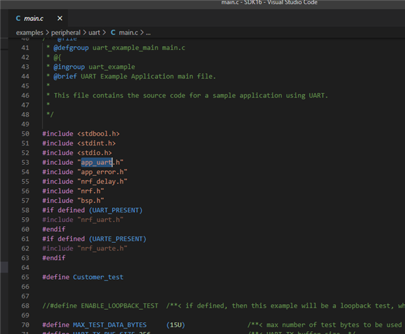

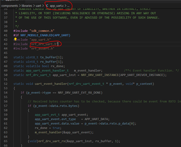

     The drivers are usually included indirectly in the main file of the project. For instance the UART example from the peripheral folder includes the high level app uart driver which again is dependent on the lower level uart driver.
