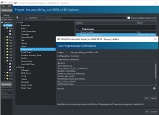

    Have you defined DEBUG in your preprocessor defines?
    In that case, please use APP_ERROR_CHECK instead of VERIFY_SUCCESS - verify_success only check whether the passed argument is NRF_SUCCESS and if not it only returns the error code. APP_ERROR_CHECK calls the error event handler in the case that the error code is not NRF_SUCCESS. In the default case, we will then know what caused the error by looking in the log.
    You can define DEBUG in Segger Embedded Studios as shown in the included picture:

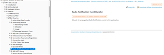

    Yes, this is possible, as we have spoken about earlier. You will have to do this using Radio Notifications. Please see this ticket for further information.
    However, I must again mention that it is not guaranteed that advertisements are received by the other devices, so by transmitting data using advertisements you must anticipate some packet loss. There is also no retransmission on advertisements, so this might mean that your advertisement never is hear, and the data is lost - without any feedback.
    Based on your previous comments I am inclined to think that packet loss might be an issue in your project, and you might therefore want to send the advertisements multiple times, to increase the chance that they are received successfully.

  • hi Karl
    the radio library you are talking about, i could not find it in the sdk 16.0, the branch is empty
    am i missing something ?
