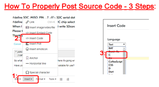

  • It would be a lot better  to copy & paste the text - rather than a picture.
    Post the text as for source code - just omit step 3.
