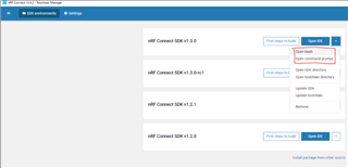

Now we build/flash/debug in command lines. It is not difficult: see https://developer.nordicsemi.com/nRF_Connect_SDK/doc/0.4.0/zephyr/guides/west/build-flash-debug.html
Main commands we use:
west build -b yourboard
west flash
west debugserver
And we use Ozone J-Link Debugger (https://developer.nordicsemi.com/nRF_Connect_SDK/doc/latest/zephyr/guides/tools/nordic_segger.html#segger-ozone) to perform debug
Note:
The most important: to successfully execute west, open command prompt like this
Yay, this works! Thanks!
Somehow i could not make west recognise my custom board, but the CMAKE/ninja command did work. I just peformed my first SHA-256 hash
