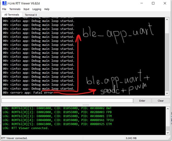

I have successfully utilized a few examples in the SDK15.3 directory on my PCA10056 including the PWM driver, BLE_APP_UART and SAADC.
Also I could merge the PWM driver example and the BLE_APP_Uart.
now that I have tried to add the SAADC example to my code, everything stops working, e.g. all the LEDs that are controlled by the buttons and the PWM driver and the UART output on my terminal... only a blank line is added on each loop. (neither log or printf work).
the code is built and flashed on the core successfully without any errors.
when I try to debug my code using Keil5 it shows that the program stops somewhere like "NRF_BREAKPOINT_COND", I am not aware what it is for. Here it is:
The code is quite large in the main.c file but as its built without any error I only add main function here:

  • What do you output on the RTT if you restart the cpu after you've connected with the RTT viewer?
    ie. "nrfjprog -f nrf52 -r"
    Can you share your sdk_config.h file?
    Its just the same as before...
    Where shall I use it? I program my chip using Keil5. Do you suggest that I use the segger tools?
    Here it is:
    6136.sdk_config.h
  • The sdk_config.h looks okay, but there might be stuff I'm missing.
    The ble_app_uart should have RTT logs enabled by default, can you try the ble_app_uart example and see if you get logs outputted to your RTT viewer?
  • I have tried the BLE_app_uart example and I found out that my rtt viewer was too old for nrf52840!! I downloaded a new version and it seems to work fine. I receive my logs in the rtt viewer, but still it doesn't help on my own project, it only sends a "fatal error" massage. even I increased the logging level to 4.
    I have attached a screenshot of it..
    Here is my main.c file. I have not added much things except for the saadc and pwm configuration:

  • You need to add the DEBUG flag to your list of preprocessor symbols.
