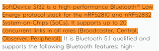

    I am confused with the brief overview of S132,
    This line confuses me. If it is stated there that s132 is a protocol stack for nRF52810 and nRF52832, then why is that there is no example in the SDK for nRF52810 using s132?
    Also, based on the compatibility matrix of nRF52810, the latest version of the softdevice no longer supports the chip, why is that so?
    If it is because of the complication regarding the memory size of nRF52810,hence it is no longer supported on the later version of s132, shouldn't there be an adjustment with the overview of the software to avoid confusion and misunderstanding. Because reading the highlighted statement, it highly implies that the s132 can be used in developing nRF52810 no matter what version it is.
    Thank you in advance!
  • Hi
    All of the PCA10040 examples in the SDK can easly be modified to emulate or transferred to nRF52810 hardware. A user guide for this can be found in the SDK documentaion over at the Infocenter. There are no examples explicitly for the nRF52810 because we don't have any Development kits with the nRF52810.
    Simon
