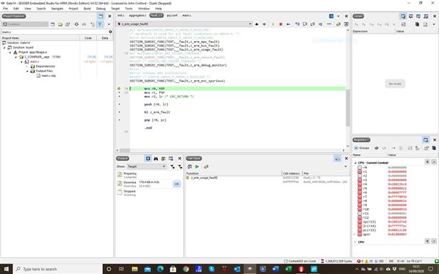

I can run the following code within main.c successfully, but it produces the error as shown in the attachment upon execution of k_free(mem.ptr)  from with aggregator.c. Any ideas why it is not working?

  • With CONFIG_RESET_ON_FATAL_ERROR=n
    Set in SPM and the ns part I have the following before it gets to k_free
    I'm happy to share the code with you, privately if possible.

  • I ran it again.
    Got a more interesting result: after K_free executed
    Memory allocated:[00:09:10.317,321] [1B][1;31m<err> os: ***** HARD FAULT *****[1B][0m

    John said:
    Faulting instruction address (r15/pc): 0x0002625e[1B][0m
     This seems to be the culprit.
    You can use the tool "arm-none-eabi-addr2line -e build-folder/zephyr/zephyr.elf 0xFAULTINGADDR" to resolv an address to a specific line.
    John said:
    os: r3/a4: 0x0000090c r12/ip: 0x200228b4 r14/lr: 0x00026523[1B][0m
    Addresses starting from 0 and up to 0x100000 (1M) is flash mapped. 0x200????? is RAM mapped.
    RAM is usually not handled by the addr2line application, so in that case, you can have a look at the zephyr.map file to see what is happening.
    John said:
    os: Current thread: 0x20022b0c (unknown)[1B][0m
     If you check the .map file, you should see which thread/stack this memory belongs to.

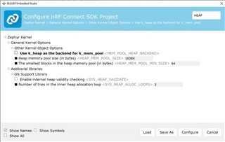

  • If I do this the problem seems to evaporate and k_free doesn't fail.
    Should this be necessary to do ?
    Also should it be done in SPM as well ?
  • Or perhaps and easier way is CONFIG_MEM_POOL_HEAP_BACKEND=n in prj.conf
    However I'm unsure if this is the right thing to do.
