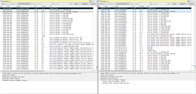

  • Finally got this working.  Lines 11659-12577 represent a failed reconnect effort.  Lines 12642-13580 represent a successful one.  The firs obvious difference is that an MTU exchange is not happening.  Beyond that, I'm unsure where to look for clues as to what is not working properly.20200925 - full capture.pcapng

    I am not sure if I understand what is actually failing, because both instances show that the peers do connect, they encrypt, and for instance the battery level is notified from the peripheral to the central every 2 seconds. So I guess the question is, what is not working here? What happens if you for instance press a key?
    There is nothing in the logs that indicate an issue with the peripheral, so if the phone behave differently then I suggest contacting apple on this issue.
    The logs do show that the phone for one of the connections do also execute a write to the CCCD's, however the application on the peripheral do not require this, as the CCCD's are already stored from previous connection and thereby restored on connection (which is why the battery level notification works in both cases).

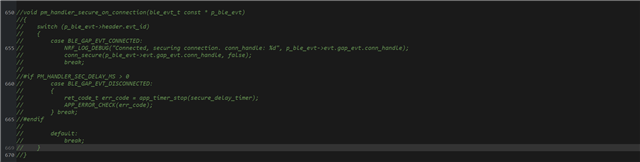

  •  pm_handler_secure_on_connection()
    was commented out in peer_manager_handler.c for the build associated with that trace.

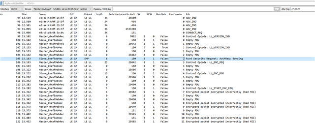

    Are you sure? Because the trace do show SMP request on both 12646 and 11661, then something else must be calling the security request in your code.

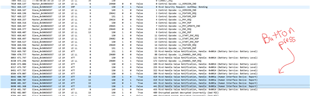

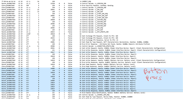

    But neither working or failing log show any key presses (that should trigger a notification for the key press), only battery level notification is shown:
    Edit: Something is not as it should be here: the central is writing multiple write requests with the value of 00 to the same handle (0x001e). This isn't really an issue and is allowed to do, but seems unnecessary. What iPhone and ios version was 20200925 - full capture.pcapng?
  • But neither working or failing log show any key presses (that should trigger a notification for the key press), only battery level notification is shown:
    EDIT: peripheral on, not connected to central:
    peripheral on, connected to central:

    Yes - just did a clean build and capture:
    edit: I only found pm_handler_secure_on_connection() being called in peer_manager_handler.c
