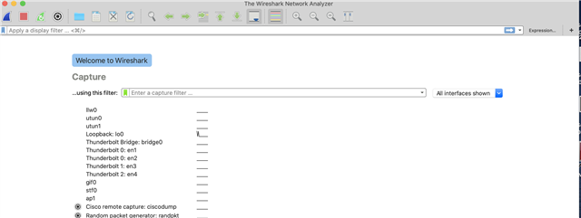

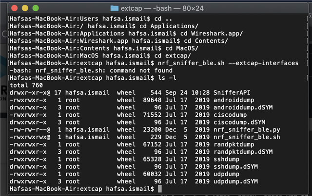

I am having an issue as I can not see the interface at wireshark. I can not run this command
nrf_sniffer_ble.sh --extcap-interfaces

You are missing the dot slash ("./") in front of nrf_sniffer_ble.sh
Still no interface in the wireshark??
Do you have more than one installation of Python3 on your system, and in that case, is the pyserial module installed to all of them?
