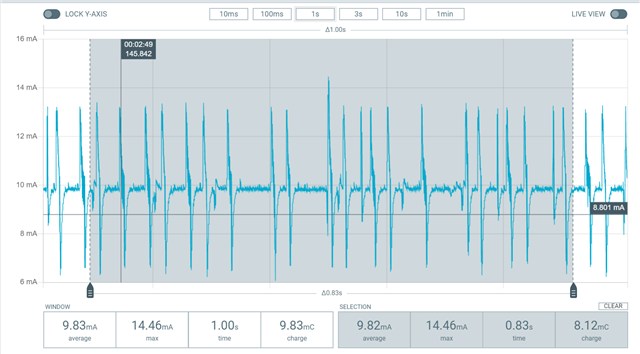

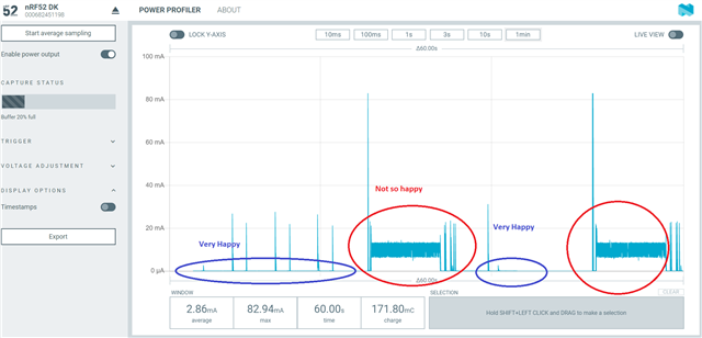

    Here is my result for PPK
    I power down my board 2 times.   As you can see,  during the joining,  there is a long period of high power consumption.   I zoom on one of the segment.
    During the joining,  there is roughly 8 to 10 seconds process that consume high current.  My multi-meter cannot catch the peak to peak voltage.  It measure 8mA which is pretty consistent.
    You can see that the sleep current after joining is above and beyond very good.  A lot harvester can work with it.  However,  the joining process is very concerning.
    You did mention the broadcast interval on your test was 2.5 seconds if I remember correctly.   If I can get that interval,  I think I can work with it.   But, 8 seconds is a bit long.   This is a code in zigbee library that I do not have access to.
    Please let me know what you think.
