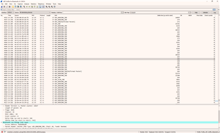

    The COVID situation escalated again in this weekend, so I won't be able to test the sniffer firmware on the Dongle today I'm afraid, but I should be able to during the week. I did however test with an nRF52832 DK as well, and did not have any problems with installing the latest nRFSniffer firmware (v3.1.0) or flashing it onto the DK. You can see the screenshot below for reference.
    I also asked around internally, and none of my colleagues have seen any issues with the latest nRFSniffer firmware and the nRF52840 Dongle. A suggestion as to what might be going on:
    • Have you removed the v3.0.0 Wireshark profile from Wireshark and added the latest Wireshark profile according to "Adding a Wireshark profile"?
    • Have you added the nRF Sniffer capture tool according to the "installation guide" here?
    • Please make sure that you program the correct sniffer firmware .hex file onto the Dongle. sniffer_nrf52840dongle_nrf52840_7cc811f.hex is the correct .hex file for the nRF52840 Dongle.
    As far as suggestions to other sniffer solutions, I don't have any real suggestions as we generally use the nRFSniffer or Ellisys sniffer to do sniffing, neither being open-source I'm afraid.
    Simon

    I made it to the office today and tested the BLE nRFSniffer (v3.1.0) on a new nRF52840 Dongle and did not have any trouble adding the BLE sniffer profile to Wireshark nor finding the Dongle as an available sniffer. Please see the screenshots below. I found one step that's easy to miss during setup that might cause you to not see the sniffer device. After the necessary modifications to Wireshark is done, please make sure to enable the nRF Sniffer capture tool in Wireshark by:
    1. Refresh the interfaces in Wireshark by selecting Capture > Refresh Interfaces or pressing F5You should see that nRF Sniffer is displayed as one of the interfaces on the start page.
    2. Select View > Interface Toolbars > nRF Sniffer for Bluetooth LE to enable the Sniffer interface.
    For reference, I flashed the sniffer firmware onto the Dongle using the nRFConnect for Desktop Programmer application with the sniffer_nrf52840dongle_nrf52840_7cc811f.hex file.
    Simon
