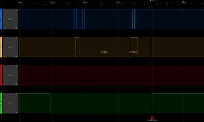

so I am expecting to get Ef,AA,2f however what I am receiving is 00 00 ef. I also connected the output pins to logic analyzer but the clk signal and miso also doesn't seems right. What am I doing wrong in the code can you provide me some feedback about it. In the original code before I just do simple modifications I was observing the loopback properly. I was receiving what I was sending so the code was working properly.

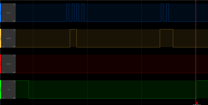

  • This is what I am seeing on logic analyzer with my initial code(without removing cpol):
    This is what I am seeing after I remove cpol:

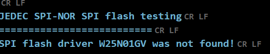

    In the output it says that:
    Can you guide me please what I am missing?

  • Can you try to do some debugging (enable CONFIG_DEBUG_OPTIMIZATIONS) and check if the init function succeeds (spi_nor_init())? As mentioned in NCS Tutorial part-3 1.3. Pitfalls the call to device_get_binding() will fail (and "SPI flash driver %s was not found" is printed) if the init function fails.
    Try to check the function spi_nor_init()-->spi_nor_configure()-->spi_nor_read_jedec_id() and see if LOG_ERR("JEDEC ID read failed: %d", rc) is triggered.
