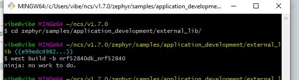

I am trying to get external_lib example application to compile for NRF5340pdk. I am using nRF Connect SDK v1.4.1 and picked the example provided in zepher/samples/application_development/external_lib. The code does not compile and does not seem to give any obvious errors. I am using a windows 10 PC for development. Do I need to do something more to get it to compile and run?

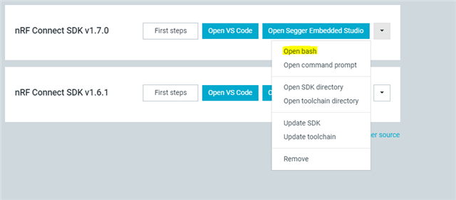

    FAILED: mylib/src/mylib_project-stamp/mylib_project-build mylib/lib/libmylib.a
    cmd.exe /C "cd /D C:\Users\Anas\Desktop\thread\udp\external_lib\mylib && make PREFIX=C:/Users/Anas/Desktop/thread/udp/external_lib/build/mylib CC=C:/Users/Anas/ncs/v1.7.0/toolchain/opt/bin/arm-none-eabi-gcc.exe AR=C:/Users/Anas/ncs/v1.7.0/toolchain/opt/bin/arm-none-eabi-ar.exe "CFLAGS=-IC:/Users/Anas/ncs/v1.7.0/zephyr/include -IC:/Users/Anas/Desktop/thread/udp/external_lib/build/zephyr/include/generated -IC:/Users/Anas/ncs/v1.7.0/zephyr/soc/arm/nordic_nrf/nrf52 -IC:/Users/Anas/ncs/v1.7.0/zephyr/lib/libc/minimal/include -IC:/Users/Anas/ncs/v1.7.0/nrf/include -IC:/Users/Anas/ncs/v1.7.0/modules/hal/cmsis/CMSIS/Core/Include -IC:/Users/Anas/ncs/v1.7.0/modules/hal/nordic/nrfx -IC:/Users/Anas/ncs/v1.7.0/modules/hal/nordic/nrfx/drivers/include -IC:/Users/Anas/ncs/v1.7.0/modules/hal/nordic/nrfx/mdk -IC:/Users/Anas/ncs/v1.7.0/zephyr/modules/hal_nordic/nrfx/. -IC:/Users/Anas/ncs/v1.7.0/modules/debug/segger/SEGGER -IC:/Users/Anas/ncs/v1.7.0/modules/debug/segger/Config -IC:/Users/Anas/ncs/v1.7.0/zephyr/modules/segger/. -Ic:/users/anas/ncs/v1.7.0/toolchain/opt/bin/../lib/gcc/arm-none-eabi/9.2.1/include -Ic:/users/anas/ncs/v1.7.0/toolchain/opt/bin/../lib/gcc/arm-none-eabi/9.2.1/include-fixed -DKERNEL -D__ZEPHYR__=1 -D_FORTIFY_SOURCE=2 -DBUILD_VERSION=v2.6.99-ncs1 -DUSE_PARTITION_MANAGER=0 -D__PROGRAM_START -DNRF52840_XXAA -Os -imacros C:/Users/Anas/Desktop/thread/udp/external_lib/build/zephyr/include/generated/autoconf.h -ffreestanding -fno-common -g -gdwarf-4 -fdiagnostics-color=always -mcpu=cortex-m4 -mthumb -mabi=aapcs -imacros C:/Users/Anas/ncs/v1.7.0/zephyr/include/toolchain/zephyr_stdint.h -Wall -Wformat -Wformat-security -Wno-format-zero-length -Wno-main -Wno-pointer-sign -Wpointer-arith -Wexpansion-to-defined -Wno-address-of-packed-member -Wno-unused-but-set-variable -Werror=implicit-int -fno-asynchronous-unwind-tables -fno-pie -fno-pic -fno-strict-overflow -fno-reorder-functions -fno-defer-pop -fmacro-prefix-map=C:/Users/Anas/Desktop/thread/udp/external_lib=CMAKE_SOURCE_DIR -fmacro-prefix-map=C:/Users/Anas/ncs/v1.7.0/zephyr=ZEPHYR_BASE -fmacro-prefix-map=C:/Users/Anas/ncs/v1.7.0=WEST_TOPDIR -ffunction-sections -fdata-sections -std=c99 -nostdinc -isystemC:/Users/Anas/ncs/v1.7.0/zephyr/lib/libc/minimal/include -isystemc:/users/anas/ncs/v1.7.0/toolchain/opt/bin/../lib/gcc/arm-none-eabi/9.2.1/include -isystemc:/users/anas/ncs/v1.7.0/toolchain/opt/bin/../lib/gcc/arm-none-eabi/9.2.1/include-fixed" && C:\Users\Anas\ncs\v1.7.0\toolchain\opt\bin\cmake.exe -E touch C:/Users/Anas/Desktop/thread/udp/external_lib/build/mylib/src/mylib_project-stamp/mylib_project-build"
    mkdir -p C:/Users/Anas/Desktop/thread/udp/external_lib/build/mylib/obj C:/Users/Anas/Desktop/thread/udp/external_lib/build/mylib/lib
    The syntax of the command is incorrect.
    make: *** [c:\Users\Anas\Desktop\thread\udp\external_lib\build\Makefile:12: all] Error 1
    [7/158] Generating misc/generated/syscalls.json, misc/generated/struct_tags.json
    FATAL ERROR: command exited with status 1: 'c:\Users\Anas\ncs\v1.7.0\toolchain\opt\bin\cmake.EXE' --build 'c:\Users\Anas\Desktop\thread\udp\external_lib\build'
    The terminal process terminated with exit code: 1.
    Terminal will be reused by tasks, press any key to close it.
    I also compiled with the -p option removed, however, it still failed.
    The 'mkdir' command on Windows does not support the -p argument. Can you try to build the project from the bash terminal instead?
