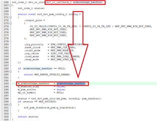

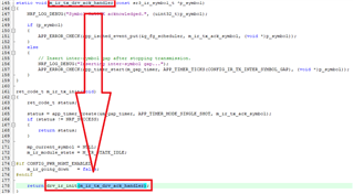

I want to make universal AC remote, using nrf52840.
I have decoded IR codes of all AC remotes which have been decoded using IRremoteESP8266 library.
Since AC IR codes are quite long and each AC vendor has their own IR Protocol, how can I send long IR codes on nrf52840?
  • hi,
    Thank you very much for such quick replies.
    I am writing IR driver for Panasonic AC. It consists of 27 bytes (216 bits) message to be transferred but at receiver end I am receiving 220 bits.
    Following is the driver code..

    argument in m_acknowledgement handler(m_ir_signal) is passed when i want to send a signal. and drv_ir_init() is called in main 's init once.
    so do you want to say that each time I want to send a pwm signal I should call drv_ir_init and call m_acknowledgement handler there with m_ir_signal as an argument?
  • No, I'm saying that m_acknowledge_handler is assigned the handler passed as argument acknowledge_handler when drv_ir_init() is called:
    It is the handler stored in m_acknowledge_handler that is called in drv_ir_send_symbol():
    For the Smart Remote FW, the handler (m_ir_tx_drv_ack_handler) is implemented in m_ir_tx.c, and is passed as an argument to drv_ir_init():
    So when drv_ir_send_symbol() calls m_acknowledge_handler(), it will actually run m_ir_tx_drv_ack_handler().
