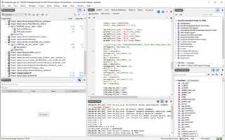

thingy91:nRF52840 int64_t convert the value to string in sprintf
Add next line in proj.conf
CONFIG_NEWLIB_LIBC=y
CONFIG_NEWLIB_LIBC_NANO=n
If you do the following:
int64_t xxx = 1609665300;
int8_t unix_time[256] = {'\0'};
sprintf(unix_time, "%"PRIu64" ", xxx);
printk("unix_time = %s\n",unix_time);
sprintf(unix_time, "%llu", xxx);
sprintf(unix_time, "%lld", xxx);
As a result
unix_time = lu
unix_time = lu
unix_time = ld
Is there a CONFIG that is not enough?
