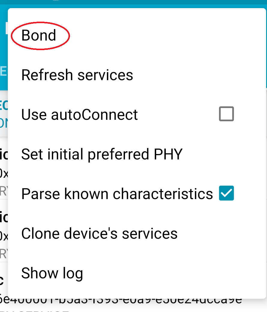

    Please make sure that autoConnect is not enabled in the nRFConnect (or custom app you're using)

    Apologies for the confusion in the video. The reconnection is showcased at 0:03 itself, wherein turning on BLE in the NRF Connect app automatically initiates a connection to multiple devices automatically without me doing anything
    I have not enabled autoconnect as you can see in the video at 0:07
