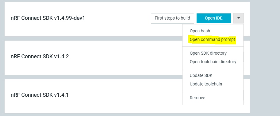

    Let's see what happens if you use the command prompt that comes with the Toolchain Manager. Could you try the following:
    • Open the command prompt through the Toolchain Manager (don't use v1.4.99-dev1 as in the image below, use v1.4.2 instead)
    • Redirect to /opt/nordic/ncs/v1.4.2/nrf/samples/bluetooth/peripheral_lbs and build the sample
      • Don't set the Zephyr Base or run zephyr\zephyr-env.cmd. The Toolchain Manager will set up everything for you.

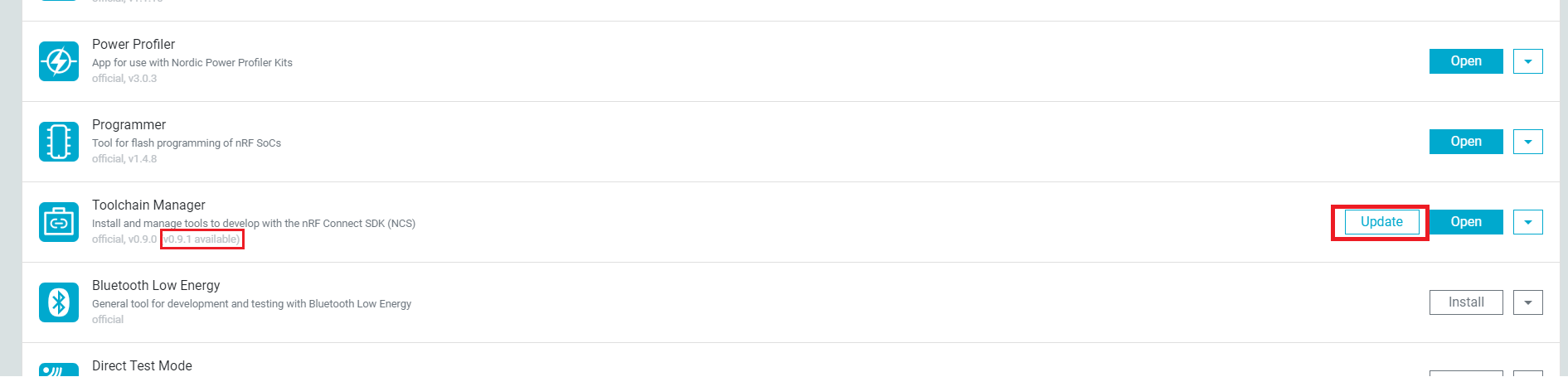

  • Could you try to update to the latest Toolchain Manager (TM):
    I got a colleague with a Mac to test the steps you mentioned (using Toolchain Manager v0.9.1)
