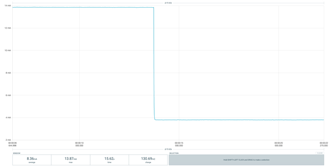

    Note: The current after the program is loaded and the debugger is at main is around 14mA. The same as I see with the new SDK and soft device. However you do not get the significant drop in current in the new code.

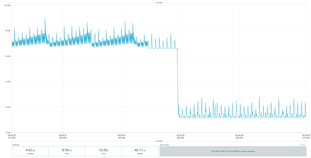

    This is the old code from power on, no debugger attachment. The average current is around 7.25mA.
    About 26 seconds after power on the consumption drops to 1.3mA and stays at that level.

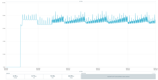

    Either I don't have the PPK setup properly or there may be a hardware issue? Below is a screen capture at startup. It appears that the baseline power consumption is [email protected] with only the BLE initialized. When the DCDC regulator is enabled the consumption actually went up! The capture you provided suggests that the baseline power should be around 5mA and with DCDC enabled it goes lower. I captured this several times to make sure my eyes were not deceiving me.
    I'm not sure how you have connected your board to the PPK, but I do not think that 14 mA is caused by the nRF52832 chip alone, that would then have to be with the radio enabled in TX mode with highest output power, or radio and CPU running at the same time. "Baseline current" in my test is the CPU run current.

    I want back to the original code base which was SDK 15.2 and S132 6.0. This operation is very different.
    Not sure what happens in this screenshot, but I think there is no way that the DCDC regulator can reduce the current from ~14 to under 4 uA.
