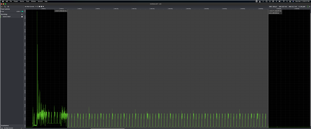

nrf9160 PSM mode strange current profile
I'm working on getting PSM mode in LTE-M working so I can go to very low current operation between transmits to the cloud.  I have things working pretty well, but I'm confused about the current usage profile.

You can see that my TAU timer is set to 20 hours and my RAT timer is set to 0 (no active time).
This works, and I observe the periodic TAU in the current profile.
However, when I transmit, I get this current profile:
The part highlighted in dark grey is what's confusing me.  It's about 20 seconds long and is a series of impulses about 320ms apart.  What is this?  My RAT timer is zero and if I make it non-zero, the active time is just tagged onto the end of the profile above.  Is there a way I can adjust or possibly remove this 20 seconds of impulses to keep current consumption low?
